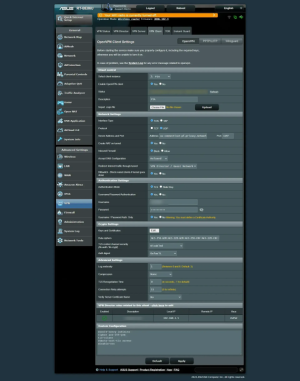

I might have found a bug, could be wrong but using DNS Director and unticking an entry seems to work but the GUI still shows the entry as enabled.
Sorry if someone else has mentioned this in the thread already.
EDIT: VPN Director not DNS Director.
Can you post a screenshot? To me, “unticking” suggests a checkbox, but there aren’t any checkboxes in DNS Director.
