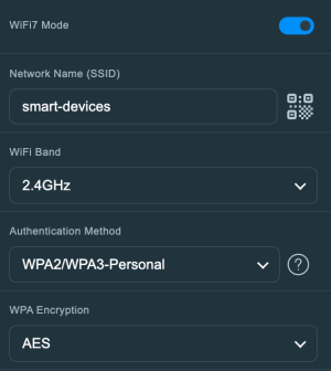

This version contains the same issue as with the latest ASUS release. Older WPA2 devices do not work on WPA2/WPA3 combo. I had to downgrade encryption to WPA/WPA2 on my "Guest" network. I don't use it for guests just for older devices but it's not isolated from my main network. Specifically affects my old Cannon printer and 6 year old Wi-Fi connected Culligan water filter. It's an ASUS problem but wanted to make sure y'all are aware here.
Don't blame the router, blame those old IOT devices! They don't support the newer things. That's why there's a special 'IOT network' type..
I have yet to find something that does not connect on this network.
I have stuff that needs WPA2/AES and will not work if I set up AES+GCMP256...
Even my (2013) Samsung Galaxy Note 3 can use this combo of authentication/encryption combo 😉
So, this would most likely be your problem rather than Asus/Merlin issue.
Unless your gear depends on TKIP+AES. Then WPA/WPA2 is required to enable that.
Not a bug unless you know the hardware supports specifically the WPA2+AES combo.

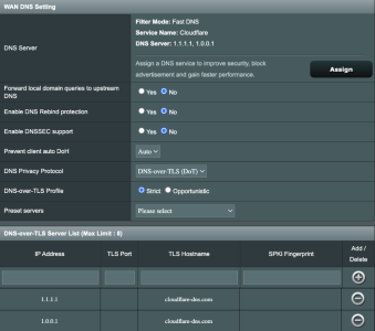

Further testing... This (see picture) and selecting a client as Router or No redirection in DNS director. https://one.one.one.one/help/ passes this as fine with DoT.
Passing everything and lists correct Cloudflare at https://dnscheck.tools/ however at the same time response time acts as slow as if it was using ISP DNS (default ISP DNS and no DNS director). Normal?
Using Cloudflare in DNS director, then it's speedy and great, but not using DoT (think that part with no DoT is expected though).
But the response time turning to terrible ISP values despite using Cloudflare in WAN DNS settings (10 times longer) 😉
Is it part of some known problem or expected?
Do you have any hits on these rules? Maybe your browser is trying DoT and getting rejected.
iptables -nvL DNSFILTER_DOT
ip6tables -nvL DNSFILTER_DOT
With the DoT or default (ISP), pretty much the same. (shortened it down a bit)
0 0 REJECT all -- * * 0.0.0.0/0 0.0.0.0/0 MAC * reject-with icmp-port-unreachable
4 256 REJECT all -- * * 0.0.0.0/0 0.0.0.0/0 MAC * reject-with icmp-port-unreachable
0 0 REJECT all -- * * 0.0.0.0/0 !192.168.50.1 MAC * reject-with icmp-port-unreachable
0 0 REJECT all -- br55 * 0.0.0.0/0 0.0.0.0/0 reject-with icmp-port-unreachable
0 0 REJECT all -- * * 0.0.0.0/0 0.0.0.0/0 reject-with icmp-port-unreachable
I recall messing around here several months back (AX88U)... I regularly ended up with for example my bank site and app not being allowed to work. Don't recall if I wiped and gave up on that part eventually, or if it magically decided to work after the wipe. Just know when not modifying this it was not problematic.
What I recall, though, I had Cloudflare's fast response in the tests as expected (same settings). So this behavior is new for BE88U. Never tried DNS director on AX88U, nor used exactly everything I do now. So perhaps multiple differences.
Funny you should mention that because that's exactly what it was. The devices needed TKIP. Why this is an issue now and not with the last version I'm not sure.
Maybe it was dropped intentionally. It's described like this "TKIP is no longer considered secure and is now deprecated". So maybe it has been left on for WPA2 for backwards compatibility before but has been dropped now.
