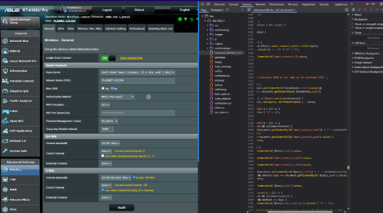

I can't click 'Apply' here and change any settings.
Already identified here:

related to ai mesh. is there any way to fix it without removing the mesh node and readding it or anything like that? will disconnecting the node temporarily do anything? thanks
You can temporarily disable the conflicting setting. Retrieve the current value, then set it to 0:
nvram get dwb_mode
nvram set dwb_mode=0
Load the Wireless page, do your wireless changes, apply, then reapply the original value:
nvram set dwb_mode=PREVIOUS_VALUE
nvram commit
Asus is still looking into the issue, I'm waiting for a fix from them since I'd rather they develop a proper fix than having me implement just a partial workaround.
