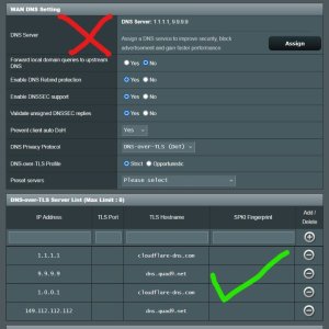

Something new? Cloudflare is not listed in DNS server. If I add it anyway as a custom, it is detected as Fast DNS. Only Google is listed as a predefined Fast DNS option.
In DoT though Cloudflare is listed as an option.
That is not DoT., if that is what you said and meant (I think - not sure!).. That is Normal DNS (non-DoT and at boot).
Like this, bellow is for DoT:
Different lists. The DNS list is managed by Asus, and Cloudflare never was there. The DoT preset list is managed by me.
Ah. I could almost swear Cloudflare was listed under both lists before.
That's why I wondered why it was removed 😉
Memory must have played a trick on me.
Exactly, 2 different lists. With DoT I refer to the lower section list that I later can add to the section outside of my screenshot.
No, Cloudflare exists on the local router’s version of the DNS list, but then gets overwritten by the remote Asus version of the list. See the local list at:
(adjust for your usual browser URL)
Cloudflare is in both, but not showing in the GUI. This is because the “confirmed” value is “no” for some entries. The gui ignores those.
The local copy is pulled from Asus' own servers, I don't maintain my own list. It gets updated when I update the various built-in databases, downloading them from their servers:
Yes, got confused when I saw Cloudflare in the local copy, then debugged to learn that the UI ignores entries where “confirmed” key is “No”.
Yeah, seems to be some mechanism Asus uses to disable some entries. Might be because they are waiting to obtain permission from these providers before enabling them. I know of one DNS provider who actually went through some email exchanges a while ago to discuss legalities before Asus would add them, I was involved in their early discussions for that provider.
These lists are a balancing act. Everyone wants their favorite providers to be added. But if you end up with a list with 50 entries, it will become useless as people won't know what to use, and the people who do know would just manually enter the IPs anyway.
And honestly is this not the best way to go anyway. Takes seconds only.
The main reason for the existence of the list is to offer a few options for those who don't already have a particular service provider in mind, and they just want something to cover malware filtering, parental filtering, etc...
