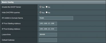

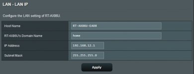

I have run Beta2 for a couple of days and found "domain name" on two places.
octopus@RT-AX86U-EA08:/tmp/home/root# nvram show | grep domain
ipv61_get_domain=
ipv6_get_domain=
lan1_domain=
lan_domain=home
local_domain=router.asus.com
wan0_domain=my provider.se
