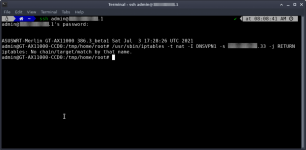

I cannot reproduce your issue here, works fine for me when I exclude my tablet. Can you test using a PC instead of the Roku?
EDIT: I can actually see one scenario where it might be problematic: if your VPN provider uses a non-public DNS server. WAN clients aren't currently "excluded" from using it, this is actually a bug.
Can you try connecting your VPN, then running the following command?
/usr/sbin/iptables -t nat -I DNSVPN1 -s 192.168.1.100 -j RETURN
Replace DNSVPN1 by whichever instance you are using if it's not the first one, and replace 192.168.1.100 by the IP address of your Roku.
Then test again the Roku.
@sorachan VPN works great, again it's only when I try to go around the VPN that the Roku loses internet. BTW time is correct.
@RMerlin I am quite sure my goof here but this is my output.
Also @RMerlin I have tried out NordVPN and all systems go. Everything works with split tunnel. All apps work through the VPN as well, except Vudu . Nord seems slightly faster than Express as well so I will be sticking with Nord. If you think the problem I was having with Express could have been a bug I will gladly test for you.

Were you using the first VPN client? If not, adjust the number in DNSVPN to match the client you use, and also make sure you do have that client DNS mode set to "Exclusive".
