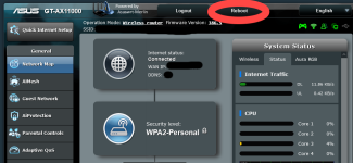

The "REBOOT" tab has no effect on my GT-AX11000, the router doesn't reboot when it is pressed.
The only way to reboot the router is to use the power button or reboot via the android ASUS router app.
Any ideas anyone?
