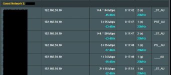

Same IP assignments in Guest #2 is still present in Beta1, it seems cosmetic as they are leased the right IP's according to Network map and the DHCP lease entries. These guest clients are manually assigned IP's in the DHCP server. sameIP.jpg
RT-AX88U
