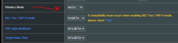

What do you mean by "cannot change the wifi modes"?
I'll need a bit more info than that if I am to do any kind of debugging...
Wireless mode.... To change from auto to AX mode or AC/N/AX mode. It simply will not make the change. Keeps being stuck on Auto on 5ghz-1 and AX mode on 5ghz-2....
I'll have to see if I can reproduce it.
