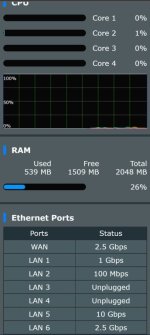

Hello guys RMerlin how you doing
I have two zte MC7010 outdoor routers these router support 2.5Gbps ethernet and i have one ASUS GT-AXE16000 the two zte feeding the asus router with internet but i have weird problem on network map on system status don't know if you guys that having that problem too the problem is that sometime these two routers shows 100Mbps and sometime showing full 2.5Gbps the two not one of them and by the way i am using them with load balancing i attach the 3 photo's one on the asus stock factory firmware and the latest merlin beta2 and tried beta1 same problem maybe rmerlin will help and thank you for the incredible firmware's and supports rmerlin.
Maybe it needs fix for it it's bug i think. I disable all the following features: AiProtection, Traffic Analyzer, Web History, Adaptive QoS, Game boost, Web & apps filters, bandwidth monitor and everything is good i don't use wireless i disable them all even maybe in the future i use it.
I have disconnections even on the system log and there's second weird problem after disabled the wireless all bands the lights on asus router are on accept 5Ghz-2 are off i did a scan with a phone to see if the wireless are on but they are all disabled forget to mention these above i add more photo's.
