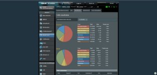

yes just wondering when my sister's router is different on the classification picture but still yes have done the same update or can the model years do their thing with the software as it was from the beginning
