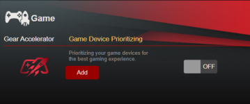

Found out that without flow cache enabled I cant achieve 1 gig speeds on any device. But having flow cache enabled Wireguard wont work anymore. Why is that? Should I just disable wireguard VPN on my router and not use it on VPN Director to my NAS and instead install Windows software for Wireguard on my NAS to achieve better speeds for all devices in my network. I really wish that I could use my router for this.
Retracing my steps, I remembered enabling this and configuring my PS4 to use it.
Disabling it did nothing. Even after a reboot.
