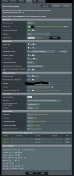

I'm having a strange issue with OpenVPN Client settings.
I'm using a SurfShark UDP Profile and have my OpenVPN Server clients going through it using Director. I have set director to 10.8.0.0/24.
When I connect over 4G via the OpenVPN android app I can access my AX88U every time but sometimes the internet connection is not working. If I go to OpenVPN Client and just click Apply I can access the internet again.
Clearly there is an Internet connection as I can get to the router but I don't understand why it doesn't let me browse the the internet and clicking Apply on the OpenVPN Client screen fixes it for a time.
