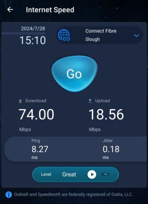

My line speed is 80/20 realistically I get out of that 74mps download and 19mps upload when doing a speed test so that's pretty darn good . With cake on I can get around 74.5mps and still 19mps .

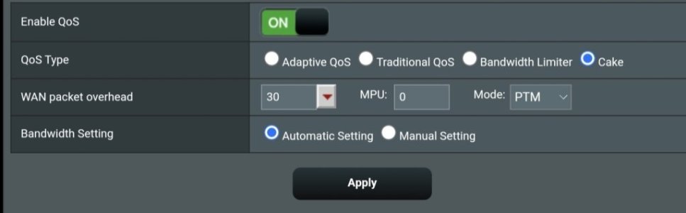

Hi Buddy thanks for that much appreciated! 👍
Yes Oddly enough I have my MTU set as 1492 on the Asus RT-AX86U Pro settings it self actually EE UK technical told me they have it set to 1492 and it set it automatically once I put in my configuration when putting in my username as password as I have the 86U Pro set as "router" mode to my previous TP-Link VR9600 router which is set to bridge-mode (dumb ADSL2 modem) so I know that is set 100%. The TP-Router has a very high quality Braodcom chip set so I decided to use that still as my dumb modem why not it's better than the cheapo ISP free router they give out lol .I purchased that back in 2015 and serviced it a few times now .
I then did a Ping test on my laptop to make sure I was not getting any fragmentation what so ever so I did a Ping test to Google 8.8.8.8 and Cloudfare servers and it was absolutely spot on ..
I started at 1400 and worked upwards 1450...1460...ext.ext then ...
1464+28 for the header which gives me 1492 and all packets were returned unfragmented bingo . I ran this again only a few months back to make sure as I had already perform this test last year.
So do I put 1492 were it states MPU ???...👀.
I will also look at the other information you have Kindly provided I presume I leave it at "PTM" as it's ADSL2 FTTC .
Many thanks 🙂

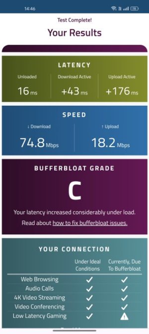

Hi I just ran the test a few times and it seems to settle on need results. 👀🤔. Thanks .

Did you follow the advice:
Disable any bandwidth-heavy tasks on your network
It’s important that your Internet connection’s upload and download connections aren’t saturated already.
Make sure no devices are currently uploading or downloading large files from the Internet (e.g. backup/sync tasks by Google Drive, Dropbox, etc).
It seems something is not ok with your config...

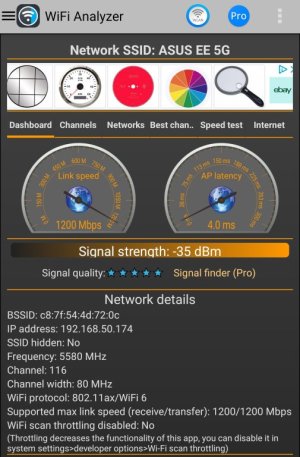

Well I ran it using my Oppo Find X5 Pro using WiFi 6 AX and it's on channel 116 (UK) theirs absolutely no one else on the channel but me 😁.
Nothing else is on using the network but my phone and it's been rock solid for well over 1 week now . I dont seem to get any buffering issues when streaming and it's virtually instantaneous streaming 4K content.
What should I check that could be causing issues.. I ran speed test also via the router it self and it gives the same download and upload speeds and that was even before Cake Qos was switched on so it's more or less giving the same speeds .🤔
I also just ran this from the Asus app and the speed test from Asus router directly and both give the same results .

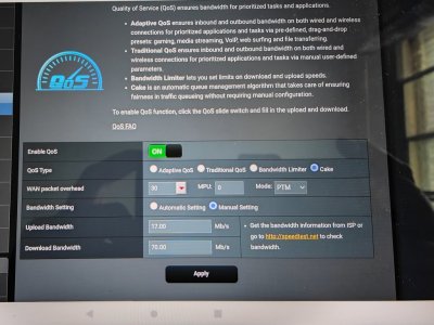

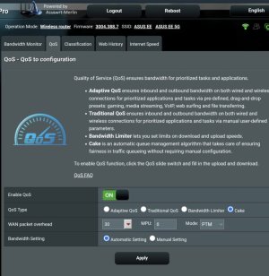

Cake can't really work unless you manually set the ul and dl bandwidth on the QoS page, 5-10% lower than your tested speeds. Do that and then run the bufferbloat test again. That is more important than any of the other settings really. With the bandwidth lowered enough and the line not otherwise being used when running the bufferbloat test (the test itself it will use it enough) then you should start to see only +1 or 2ms, and A+ ratings.
Try 70 down 17 up to start and if not getting results that good lower it a little more, it is sacrificing peak speeds for better user sharing.
Hiya ,Thank you for that much appreciated 👍... However ☝️slightly confused I understand what you are saying but if that is the case then why is their a "automatic" setting surly that should be enough and let the Program-addon run it self...??
Then why have that in place it would make no scene 😕👀🤔...

As stated above then why have a "automatic" setting?? I🤔👀🙂
Give it a read:
The basic, is that has @Tech9 said:
Tests and experience. Automatic means no bandwidth limits. Adjusting upload/download limits manually and below 100% CPU load works best. On AC86U that means below 300Mbps. For faster ISP lines Cake (the CPU) will limit WAN-LAN throughput. Cake is incompatible with Runner/Flow Cache.
Automatic setting was originally for the other QoS types. When cake was added, it came to mean “bandwidth unlimited” so cake will not try to control the bandwidth, but only the fair consumption of unknown bandwidth. Don’t use Automatic.

i e 70mbps down and 17mbps up m see how that runs see how this goes ...this should prove interesting 🤔 ☝️🙂
I presume I leave "MPU" at default "0" ???
I presume I leave "MPU" at 0 default??? I won't touch this. 🤔🙂

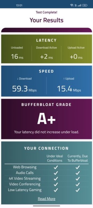

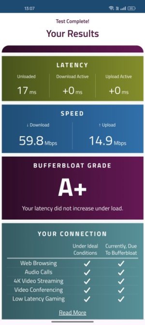

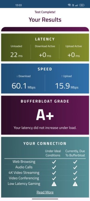

Hiya everyone Okay update from me....Okay okay you guys were correct I hold my hands up ☝️😁..
It seriously worked with what you all said .
So this is based using my mobile phone which is Oppo Find X5 Pro which is AX compatible WiFi 6.
Using DFS channal 116 @ 80mhz (Asus RT-AX86U Pro) latest MerlinWRT software well the 2nd lastest not the VPN Kill switch update .
I ran the test 3 times to check for absolute consistency and each of this 3 times came back A+ that's a huge difference from before!!!!!.
I based it on using 10% bandwidth so 70mps DL and 17mps UL here's the screenshots I took .
