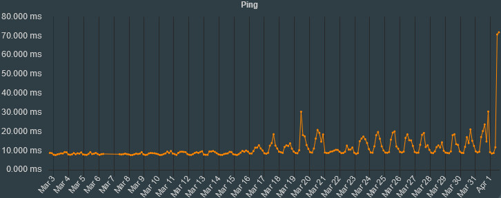

Although I had not interactively noticed Comcast's service deteriorating, connmon was showing that it has been over the past weeks during business hours. Today I am unable to conduct voice communications over VPN to work. I have been getting the following in syslog.log throughout today.
Apr  1 15:34:10 WAN_Connection: ISP's DHCP did not function properly.
Apr  1 15:34:15 WAN_Connection: WAN was restored.
Apr  1 15:40:13 WAN_Connection: ISP's DHCP did not function properly.
Apr  1 15:40:19 WAN_Connection: WAN was restored.
Apr  1 15:43:19 WAN_Connection: ISP's DHCP did not function properly.
Apr  1 15:43:24 WAN_Connection: WAN was restored.
The workaround is to use Webex on my personal phone over the T-Mobile network.
The cable modem logs have no errors since 3/15/2020. The cable modem status page shows strong signal with no accumulating errors.

those look like waves in the ocean followed by a connection tsunami, what did you do to resolve this dilemma?
There is nothing I can do. It is an ISP capacity issue. Municipal broadband and FIOS are not available.
