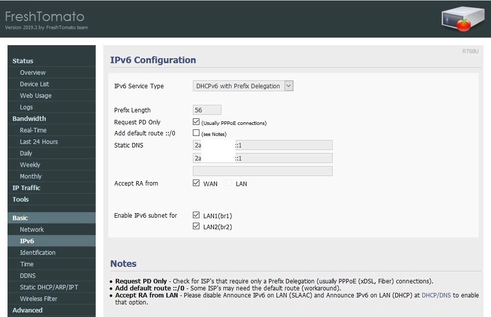

I recently figured out that my ISP is using by default IPv6 so I've decided to enable it in my ac-86U,but can't see the option to configure.
a user from my ISP forum posted a screenshot of the configuration I need to make in order to work IPv6,but is from tomato firmware, so if someone can help me to configure it in merlin firmware would be nice :)
I'm not sure what the default settings are, but have you tried setting Connection type to Native on the IPv6 page? If it can figure out the settings itself, then you should be pretty much sorted.

thanks everyone,with your help I tried a bit and finnaly get it working.
I'll leave here a picture of my actual configuration if someone needs it in the future.
