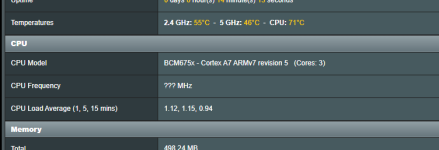

Also notice the CPU reported incorrectly(See pic), also notice that there is a increase of CPU temp of 2c.

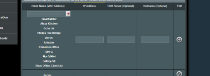

DHCP, Notice the drop down lists is open when selecting that Web page(see pic2), after the update Alexa Device app is unlinked But linked back up fine.

3. In web UI (Tools) CPU Frequency is missing.

3. In web UI (Tools) CPU Frequency is missing. <-- regression, confirmed
