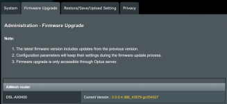

@eng1970 I have fixed the problem, but I am wondering now how you managed to install Merlin in the first place if
upgrading was disabled in the stock firmware too.. or a lest it should be there in the latest firmwares...
I am keen to know if Gnuton/Merlin firmware is able to work on DSL-AX5400 for optus, along with the installation steps if different
Old code "386.03_2-gnuton5" didn't have that to block me
@hong88 DSL-AX5400 should works on optus.
BUT please wait for the next beta 4 before testing it.
The next beta3 is gonna come maybe today.
I have seen that latest optus DSL-AX5400 doesn't manually allow to upload firmware to the router.
For this reason you may need to side flash it with Asus restoration tool or tftp... but this is just my guess seeing the source code.
I am not sure if this update has been rolled out by optus yet.
@eng1970 the block comes from latest asus's code that we merged last December. This means that Optus branded Asus routers soon won't allow you to flash custom firmware from the web UI.
