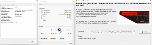

My optus router firmware is lock
Install Asus restoration tool
set IP 192.168.1.10
Unplug power. Press reset and insert power.
Red light flashing
Start tool, flash gnuton or rt ax82u
It say failed to recover the system
Did I miss anything
I think it's 192.168.0.10 /24
i tried several methods, but always ended up with system image fail
appreciate advise and help
dsl ax82u firmware
dnuton firmware
tftp, asus restoration tool
192.168.0.1 or 192.168.1.1
2 computers with LAN connection
turn off firewall
I tried both gnuton and asus dsl ax82u firmware
same message
my router current firmware is 3.0.0.4.386_43578

i tried tftp with the following settings.
still stuck with optus firmware.
cannot figure out what went wrong
