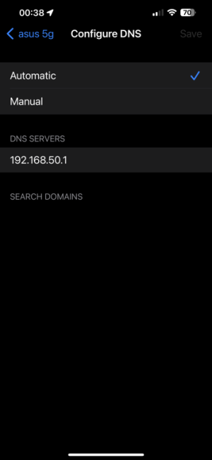

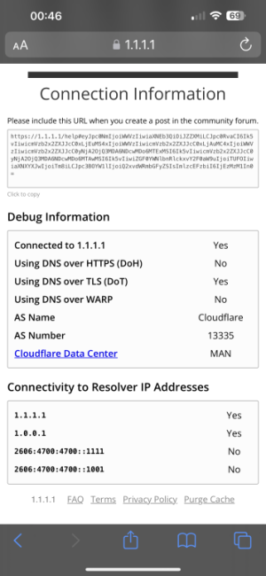

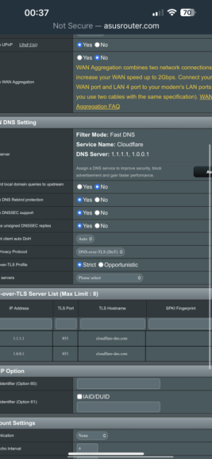

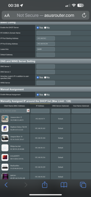

I'm setting up dns over tls but I don't think my devices are setup right,are these settings correct,I've enabled 1.1.1.1 in the wan with tls,in the lan dns 1 dns 2 I've left them blank,when I goto to cloudshare to test tls it says it working,the issue I've got is when I do a speed test on my nv shield it says my dns is 192.168.50.1 instead of 1.1.1.1,it the same on my iPhone dns setting is 192.168.50.1,shouldn't it say 1.1.1.1?

192.168.50.1 is your router, clients look up to the router, which then does a lookup to 1.1.1.1 via DOT. You can test if DOT is working using cloudflare's test.
That is the default behavior, if you want clients to see 1.1.1.1 directly you need to set "advertise router's DNS" to "no" and put 1.1.1.1 on the LAN settings. But you will lose DOT by doing that, unless you configure every client to use it.
Note however that using DoT is a bit over-hyped. There is also no need to do DNSSEC, just pick a DNS server that does that for you. I tried out DoT and found it slowed my queries down and disabled it. If my ISP wants to track what sites I'm looking up, don't really care, they can track the sites I visit anyway and everyone else (windows, google, various sites, etc) is already doing that also.
What you are seeing is correct.
Your computer and other devices are connected to your router. They cannot see the upstream DNS so from their standpoint your gateway is the DNS server. Your router then sets it’s upstream DNS to 1.1.1.1.

Think of your router as a DNS proxy server. Your clients look up to the router, the router sends any non-cached entries upstream, and replies back using its internal IP.
If you want to use DoT then you must use the router proxy feature. If you want clients to see the DNS directly, disable the router proxy, and you also won't have DoT. DoT isn't a huge issue, I mean everyone is spying on your traffic and they can figure out what you're visiting in many other ways, but you can use it if you want. On my router it slowed things down quite a bit.
Generally it is better to have the router be the proxy, caching entries locally will be faster, and you can change DNS servers anytime and it is transparent to the client.
So the recommended setting is on LAN DHCP, leave both DNS blank and check off "advertise router's IP". All clients will receive 192.168.50.1 as their DNS.
On WAN set the DNS servers you want queries to go to (1.1.1.1, adguard, etc) and optionally enable DoT if those resolvers support it. DNSSEC isn't necessary with a recursive DNS server.
If you want to ensure a client never statically sets anything to bypass the router, go to DNSFilter/DNSDIrector and set it as "router" and enable it. That way all DNS traffic is intercepted by the router and uses the WAN DNS IPs, no matter what the client points to. The client never knows, they think the response is coming from the DNS they pointed to, but in reality it is coming from the router. Note this doesn't work with clients that use DoH (I believe firefox does this by default and Chrome/Edge have it as an option). You can enable the feature on the WAN page to block client auto DOH which helps prevent those browsers from doing that, but a savvy user can still force DoH.
If you want to use DoT (like I said, if you're just looking up to recursive DNS, there really isn't any benefit) then you must use the router proxy feature. If you want clients to see the DNS directly, disable the router proxy, and you also won't have DoT.
On WAN set the DNS servers you want queries to go to (1.1.1.1, adguard, etc).
Just to clarify a very common misconception: the “Advertise router’s IP…” setting has no impact when DNS1 and DNS2 are empty. Only if either are filled in will the firmware consider the state of that checkbox.
The net result is the same, but not because of the checkbox.
So the router advertises itself by default, either way, same result. I'm just suggesting they leave it at the defaults, which is both fields blank and router IP "yes", at least as far as I recall it is, since I haven't changed mine and that's what it is set to.
