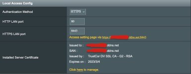

I am running Ver 384.18 of Asus Merlin on my router. I am trying to setup DDNS using freedns.afraid.org. I have created an account on freedns.org and have created the subdomain, but I am having a hard time understanding how to set this up on the Asus router. Specifically, what should be in the host name field?
Wallace_n_Gromit
Senior Member
The subdomain, in my case [xxxxxxxxxx.chickenkiller.com]
