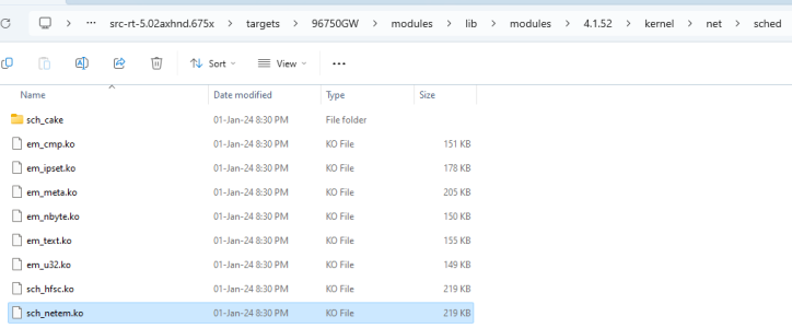

Hi all,
Probably last set of questions.
I managed to compile sch_netem.ko successfully,
- what would be the best way to load the module? modprobe vs insmod?
- will it possibly *brick my router by loading the module? How can I recover from it?
- any other precaution I should take?
*brick here refers to router being a brick and that I'm unable to ssh into it, unable to unload the module by just power cycling
I am also aware that it may affect DPI, QoS, maybe crash wireless function.
