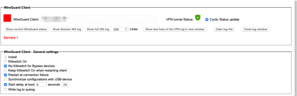

To me to NOT use killswitch is the same as not using VPN at all. Can you explain your reasoning, please?
Did you check the box for "Reboot router if Internet is down. May reboot every 150th sec. Use with caution"?

I do not use killswitch because I am not doing anything illegal like torrents etc. I use mainly VPN to overcome international traffic speed restrictions from ISP.
I don't even know where to look for a detailed logs in R9000, I have always been using Asus for many many years. The basic logs found under Admin page does not show detailed connection logs.
By the way I do have the option "Restart at connection failure" enabled, problem is the WG client does not seem to know there is any failure with the connection...

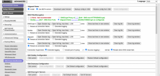

You can also switch on additional logging in Settings: DNS Privacy/Ad-Blocking: DNS Filter/Encryption: Connection Supervision: Extended logging + Include part of syslog,
and more supervision: net-lan: Restart when DNS restart fails

Hello
Yes, I was talking about setting up AdGuard Home from the Kamoj Add-on. I had that problem with invalid username too. In my case I think the username in the AdGuard Home configuration file got corrupted and I had to uninstall and delete the configuration file at /opt/kamoj/addons/defaults/AdGuardHome.yaml.
I then reinstalled AdGuard Home following the instructions in the Kamoj FAQ and going through the various setup menus. After I made the configuration changes from the gui, I made a backup using the Add-on's AdGuard Home backup button so I wouldn't have to worry about the configuration file again.

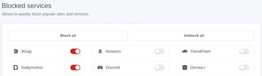

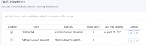

To get the Controld DOH and TLS servers added to AdGuard Home, I entered the following into Settings/DNS Settings --> Upstream DNS Servers menu. The AdGuard server in the list is commented out as I wanted to try running just controld only.
With controld I am not using any filter lists (except my own whitelist and blacklist text files stored on the opt partition of the usb drive). However, I did set AdGuard to block some services that I do not use (at Filters/Blocked services).
Although I really like DNSCrypt-proxy, I didn't have any luck adding the controld DOH server to it. I imagine you could add the TLS server to Stubby, but using AdGuard Home was easy and it has other benefits too.
Hope that helps..

R9000: I can still break WG connection and then addon gets crazy. There is a very specific way to reproduce this issue and it involves having Torguard dedicated IP. If @kamoj or anyone else is interested to see it themselves, I can PM my Skype or Telegram. I would then give you my TG config with dedicated IP, once up and running I would break your WG connection by generating a new TG config. Every time new TG WG config is generated, it breaks the existing connectivity.
Logs (supervision + WG log + hard wired PC ping since it broke): https://pastebin.com/bm9DKd5F
Don't know why WG log is not complete, I guess it is time limited. But anyway you should be able to see the issue. If not, I can reproduce this every single time.
Don't get me wrong, until I break it, everything works great. But the moment it breaks, I would expect going back to normal ISP connectivity, instead of behaving like killswitch would be enabled although it is not.
Also funny thing, manual disabling of WG client did not fix the issue, more over the green status shield remained green... Only reboot has fixed the issue:
Ah okay, I have about 5 active VPN accounts with different providers (so I can test or move to another VPN provider if one is giving me bad quality IP), the one I use the most is TorGuard, I have one dedicated in LA and SD (residential IPs). TorGuard made an announcement that recently when you generate a WireGuard config file, you will be able to log in at a later time, so will not time out (meaning your private key I guess will not expire). In the past, if you generated a config file, then used it for a bit, then disconnected from TorGuard, and came back like a day later, the connection will be invalid and you would have to re do the config again just to re connect. So making it once now, you are good to go, but I do see why you are breaking it on purpose just to test if you will go back to your ISP default.
I just tried this now, made a new config file for my WG at TorGuard, and I got kicked off of course, and waited a bit, my local ISP internet did not kick in. I checked and I have been connected for over 22 hours and still connected, but no internet traffic via Wifi and LAN. Not sure why we are not going back to regular ISP internet, seems like a kill switch. I did try to reconnect with my new TorGuard WG config file and it connected just fine. I think this is just by design, like what Kamoj said whats the use of using a VPN if you want it to go back to your regular internet ( and possibly leak stuff ).
I do get what you are saying, lets say someone in my household is doing an important business meeting, VPN goes out, the person will be frustrated because they cant get back on the business meeting if there is no internet at all, and I'm not around to log back into the router and reconnect the VPN.
I am glad we have the same VPN provider with dedicated IP to test. Yes, you are right that Torguard has recently changed its policy. Before the validity of the configs was 24 hours, meaning if you did not use it for more than that, you had to generate a new config. Now, with the recent changes, if you generate the config it says the same until validity of your account unless you generate a new one.
Well, since the killswitch is optional, then I would not say it is by design like that. There is a bug somewhere with checking if the WG connection is up or down. If you see my logs you will see that at some point, WG gives up at trying or re-trying:
16:45:48 Wireguard Client completed start sequence
16:47:58 Wireguard Client completed start sequence
And for more than 1 minute nothing, in fact nothing more has happened for several good minutes as I was watching. Also the supervision logs I posted are showing activity until 16:49:13, but there was nothing more recent in WG logs at all. I also had no ISP internet connectivity.
You can also see by my pings from PC that some pings do get through directly via ISP, which means sometimes there is ISP connectivity present for a while but either WG client restarting or retrying is breaking it - hard to say. If that would be a killswitch, then it doesn't work :)
Exactly. And this would be my least concern, as nobody except myself is going to generate a new TG config. I wanted to remind that this behaviour has happened when PPPoE connection from ISP was down for 10+ mins. Once it came back, neither WG session was restored, nor ISP internet connectivity was present. I had to untick the green box manually on WG client to make things working, which as I said, is not a desired solution especially with killswitch disabled.
Hi @blueliner , super, thanks for help. I have erased, uninstalled and reinstalled Adguard home and I can finally see some 5 steps config menu which I did not see before. Page 2/5 of this config shows the following 2 errors:
Admin Web Interface: "listen tcp 0.0.0.0:80: bind: address already in use"
DNS server: "listen udp 0.0.0.0:53: bind: address already in use"
How did you overcome this issue? Also do you have "all interfaces" checked for both?
As for controld, I mainly use it to unblock some geo blocked services, but I do have to say that filters come handy such as safe search etc. I do note there is no need to use ad filter on controld.com once we setup adguard + controld. My question is if this adguard ad block database is hosted locally on the router or some external connection is being made to check on each DNS request - but that would not make sense, as we skip Adguard DNS with ControlD in such case.
Hello Primitivo,
It has been a long time since I set up AdGuard. As I recall, the setup menu gives the option to use an alternate address:port. Mine is set for the web gui to use port 8080 and for the DNS server to listen on port 5300 . I followed the setup from the Kamoj FAQ after making sure the desired ports were available:
" How can I setup Adguard Home by myself?
A: - First stop Adguard Home:
Kamoj Menu: DNS Privacy/Ad-Blocking: DNS Filter/Encryption: None
- Delete the current configuration:
Kamoj Menu: DNS Privacy/Ad-Blocking: Adguard Home: Erase configuration
- Start Adguard Home:
Kamoj Menu: DNS Privacy/Ad-Blocking: DNS Filter/Encryption: Adguard Home
- Start setup program:
*If you access your router through it's IP eg 192.168.1.1: Kamoj Menu: Adguard Home Setup
*If you not access the router through it's IP, open: http://192.168.1.1:3000
Run the guide, it's very easy. You can select one of many available languages as well.
If you are not expert, I advice you to use these values:
Admin Web Interface: Listen interface: 8080
DNS server: Listen interface: 5300
After The last "Open Dashboard", close the window".
AdGuard itself has the option to use their hosted database for security checks, parental control and safe search. You can also use your own or third party blocklists by entering the ip address for the file location.
I have attached some partial screen shots of these options.
