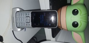

I have a Sipgate VOIP system that is being blocked by Adguard Home but cannot find the request in the query log.
Once Adguard is disabled then Sipgate can register.
Any help will be gladly appreciated
