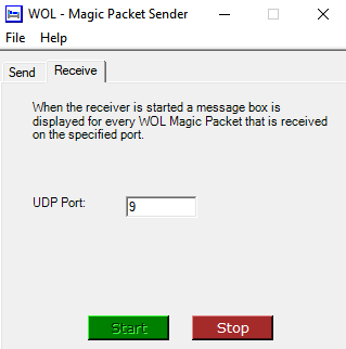

I tested the WoL on my NAS, and it worked. I tested the program you used on my PC, but it did not detect the WoL package,
so I guess Windows (in my case) firewall something takes care of that. Actually I thought the package never leave the NIC.
You can try it from command line with the debug flag set like this:
/usr/bin/etherwake -D -i br0 10:36:5A:75:55:12

I've tried the Wake-On-LAN option but it doesn't work with my desktop computer. I've used the computer MAC address (I used xx:xx:xx:xx:xx:xx format) and * but neither worked. I use this small utility http://magicpacket.free.fr/ to monitor if the magic WOL packet is properly received on the target machine.
I do not receive it using the WOL option from the add-on. I've always had WOL working with my older OpenWRT router so my BIOS, OS and network settings are correct.
.View attachment 33912

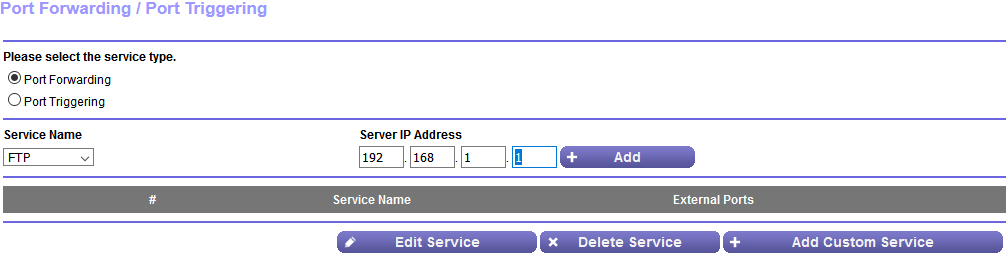

I've tried the option Unrestricted Port Forwarding hoping it will let me forward traffic to the router LAN address (192.168.1.1) when I've tried to SSH to the router Dropbear server from WAN.
I've set the router options too but I cannot establish SSH connection to the router. The router does accept the Port Forwarding rule to 192.168.1.1 to be set but connection from WAN is not possible.
