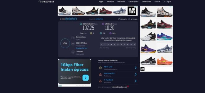

I just want low latency to be exact for better responsiveness to my games. What do i need to do to achieve that? The only info i got i told you. My results on speedtest and dslreports waveform everywhere seem problematic. Got fiber to the home and a mother and aunt using it for browser gaming or netflix. What do i need to buy to fix it? Cant have 80 download and 600 upload latency anymore 😭😢
If you have 600 ms of latency, then you have a more serious problem than just bufferbloat, and no amount of SQM will resolve that. Even if you were to be running a torrent at the same time, your latency shouldn't be that high. I recommend you start by troubleshooting the basics, i.e. test performance with nothing else using the connection at the same time, also check with traceroute if your latency jump is within your LAN or at your ISP level.

Kind of a noob. Could you please explain what i need to do? Here is my results on speedtest. My latency is measured while it downloads or uploads if i am not mistaken(so this is exactly like downloading a torrent while it is pinging) but i might be wrong.
