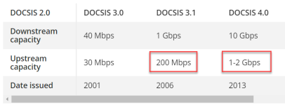

DOCSIS 4.0 capability to more than 50 million homes and businesses before the end of 2025.
Things will be changing sooner than later in the realm of CABLE. D3.x won't support Full Duplex which is where things are going with D4.0. This will level the playing field with Fiber deployments.
See pic below @ https://www.snbforums.com/threads/modem-router-combo-recommendation.83098/post-817876
The big issue with Cable has always been the upload speeds. 200mbps is nice with D3.1 but, the highest offer with any cable carrier is ~50mbps and usually only on gig plans or higher. So, if D4.0 is coming in less than 2 years it's best to have at least D3.1 since when they flip the switch you might be lucky and get 4X the upload speed for free vs being stuck at 30mbps under D3.0.

I had ordered ARRIS see my specs under my post. The had beefed my account up to their GIGABIT EXTRA most that can muster 720 mbps if your lucky to get that rate. Most I've seen 600 mbps down and 50 up. I have unlimited data with that package because I'm YouTube content creator manage 9 channel and upload 1080p 60p files sometimes 4K video. Modem should support both DOCSIS 3.0 & 3.1 mine is 3.1 shows up as blue when connected. Green for 3.0. They have to make sure you service is gear up to support your overall plan as in my case it wasn't now it is. New hub box new lines to the house. I say a wired manage router business type if you can afford it not cheap. Business type AP mount those on the ceiling. 1500 square foot house might take 2 of those APs because of any EMI/EMF electric noise in your electric lines. I use power conditioner those are use for Audio Studio Gear. I run/create Music and run a channel as well. I need clean sound without extra static in lines. I do have one for my network is housed in mini rackmount.
The information above is wrong. DOCSIS version is shifted one position to the left. DOCSIS 3.0 is up to 1Gbps/200Mbps.
Business type AP
I use an NWA210AX and it covers 1300sqft corner to corner and they're running about $150 on Amazon.
DOCSIS version is shifted one position to the left. DOCSIS 3.0 is 1Gbps/200Mbps.
Possibly, but, also knowing Comcast and other providers will be pushing off 3.0 devices to make room for FDX it's a better buy to go 3.1 and not find yourself having to buy a new modem again in 6-12 months or whatever short term period it take them to throw a wrench in the mix.
I never commented on what is better to buy. I'm saying the information above is wrong including highlighted numbers.
