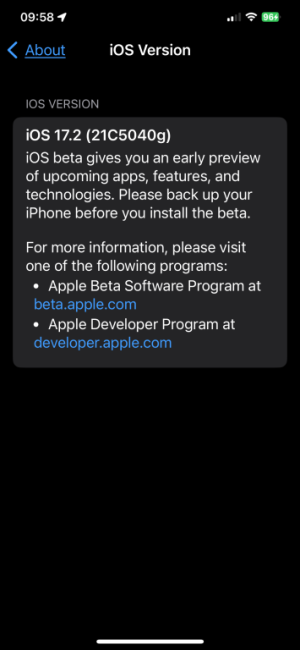

Just installed Beta 17.2 Build 2 and similar problem was fixed…
Thanks again for flagging. Indeed, the iOS and iPadOS 17.2 beta 2 updates appears to have fixed this problem for me.
