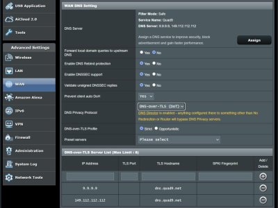

I attached my DNS setup. DNS director is “ON” with global redirection to the “Router”.

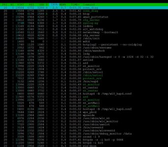

As soon as I start qBittorrent on the PC the router starts to struggle. DNS queries on the LAN are considerably slower. I do not see much in HTOP, but SSH and the GUI immediately becomes very slow (see attached pic which I took under the “load”; note the pic shows syslog-ng running, but I uninstalled it since, it made no difference, I just removed it because of its RAM usage, and I do not really need it).
Typing AMTM and pressing enter takes 15-20 seconds to register (usually many seconds between the letters). The GUI is even slower, it is very hard to get to the logs. There is no visible load on the network map page, the only visual thing what can be seen is a ton of warning about possible DNS rebind attacks about the blocked tracker URLs in the log page.

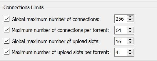

Could you please elaborate why would a heavy load crash a router? One of the very main function of a router is to deal with those kind of loads, so I don't see how would it be ok, if it would made it crash.
I agree that tables storing connection data can be quickly filled/overflown, especially with a lots of stateless active connections on routers without a proper RFC4787 implementation, but I think a single client with simultaneous TCP connections capped at 256, all that in 2023, should only lead to connection drops, hangs, slowdowns and definitely not a crash without warnings (in my opinion), and especially not minutes after the causing load happened.
It should be also noted that the 256 limit has zero issues on the ac86u, and it also causes zero issues if I set it to 1000, none whatsoever.
Something else is going on here, me thinks.
