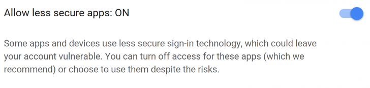

And double check 'Allow less secure apps' is in fact set to ON
I verified the setting:

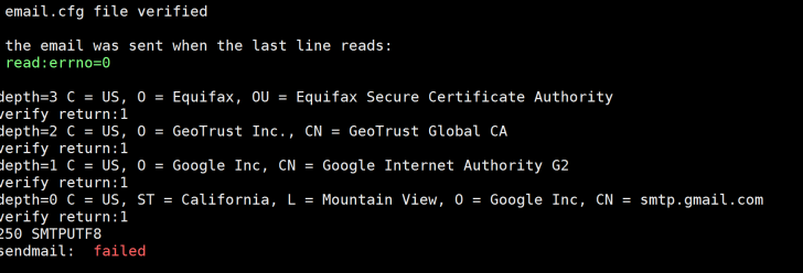

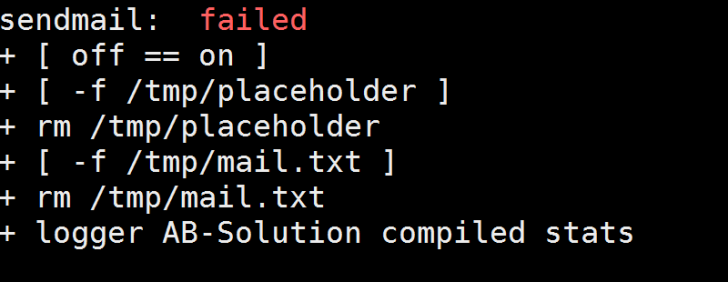

Try this: Enable a more verbose mode in /adblocking/addon/log-stats.add on line 3.
Set it by removing the comment hash (#)
# set -x
to
set -x
and save the file.
Then send a testmail again. Verbose output follows, the interesting bit is near the end:
sendmail: failed
Be careful not to post the email credentials if you paste output....

And if my previous post still does not give more clues, do this:
In the same file, set it back to # set -x but change line 160 from:
cat /tmp/mail.txt | sendmail -H"exec openssl s_client -quiet \
to:
cat /tmp/mail.txt | sendmail -v -H"exec openssl s_client -quiet \
A even more verbose sendmail output follows.

Thanks thelonelycoder, this is what was below the failed message:
