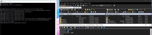

Hi
I can change the port to 53 and save but there is no restart file. My home page port defaults at 14711

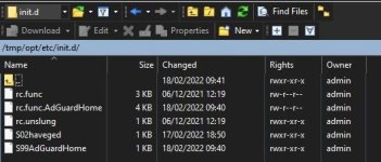

Hi
Also is there a video guide I can follow to set this up as I cannot change the DNS servers in Adguard to use 1.1.1.1 and 1.0.0.1 that is in my AC87U routers WAN DNS server 1/2 fields.
Thank you
You need to change the S61 to S99.
That post is old, the file is no longer S61, but S99. This is reflected in the first post.
