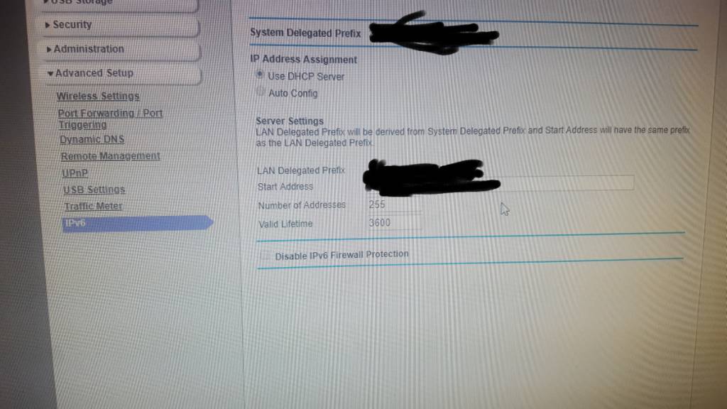

I just have regular spectrum cable which used to be Charter communications. All I did was turn on IPv6 and leave the defaults and it has worked fine for me.
Thanks, I turned on Native mode but I am not pulling any IPV6 info, evidently IPV6 is not enabled in my area or there is another problem.
Appreciate the screen shot!
Try rebooting the modem. Leave the router as is and see if you then get an ipv6. This is what I do when I loose my ipv6. I'm in the LA area.

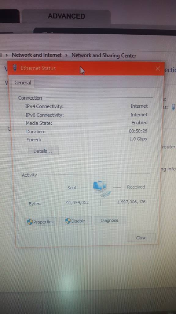

The ubee 31U2V1 does not have a user accessible configuration in bridge mode. IPV6 MUST be enabled since I am able to pull an IPV6 IP when I connect my laptop direct.

Connected laptop direct to modem, I get an IPV6 address and am able to browse.
