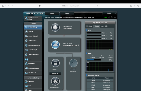

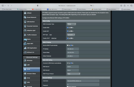

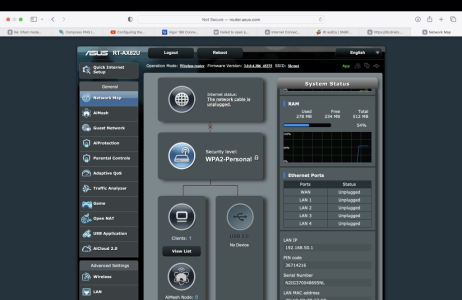

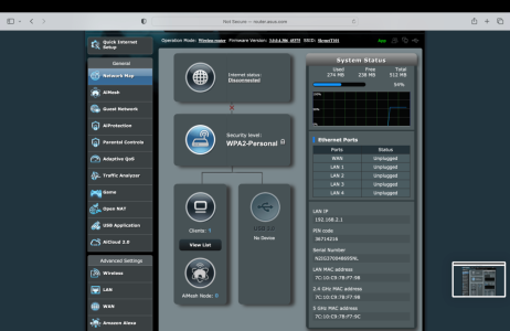

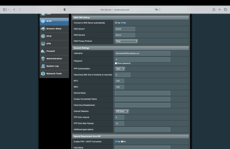

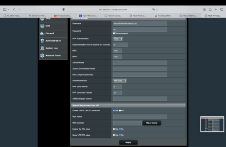

Hi. I have and had setup everything the way Asus manual recommends. A few things. The DrayTek is set as 192.168.2.1. I am pretty sure have setup the wan correctly.

With the modem/router in bridge mode the Asus router needs to be set to get its IP address automatically.
Yes, the WAN IP can't be set to some private fixed IP address. What is 192.168.2.1 there? If this is the DrayTek's LAN IP - it's not in Bridge Mode.
Your RT-AX82U has much newer firmware Asuswrt 388_22525, by the way.
I would use the ISP provided DrayTek modem/router for establishing the connection and run this Asus in double NAT with WAN IP in DrayTek's DMZ. This way the ISP is responsible for the connection and if it doesn't work properly - they have to fix it. It's super easy to setup given the user has access to the ISP provided DrayTek settings and works with no issues in most cases. It also provides some extra layer of security.

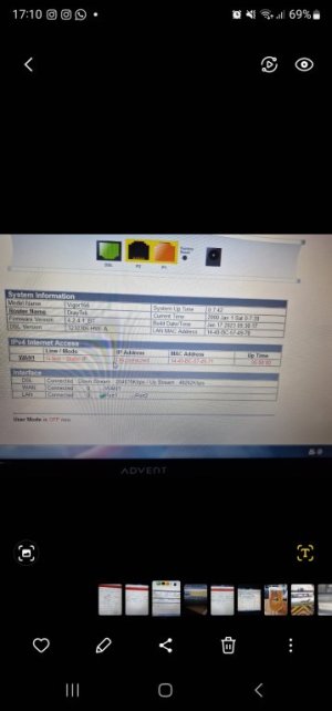

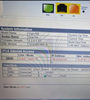

OK so this was some advice I had from another forum. All I need is the asus to see the draytek. The draytek is in modem/Bridge. One thing however I don't understand is why the draytek shows up "static ip disconnected" . The picture provided below , is this normal.
I'm sorry, I see nothing on the picture above.

I have set everything from the draytek user manual as I need to for modem / bridged. I just can't get the router to talk to the modem. Clearly I am doing something wrong In the asus. As you say , the p1 lan port is connected BUT I haven't a connection to the Wan port on the asus. No matter what I do , the 2 will not talk to each other.
Did you change the WAN IP to Automatic on the Asus? Why was there an address 192.168.2.1 as a gateway?

I was told to do this before anything else. This was from a guy on the bt forum. Judging by the sound of it , this is wrong.
I'm home shortly so will set the wan ip to automatic and re run everything.
