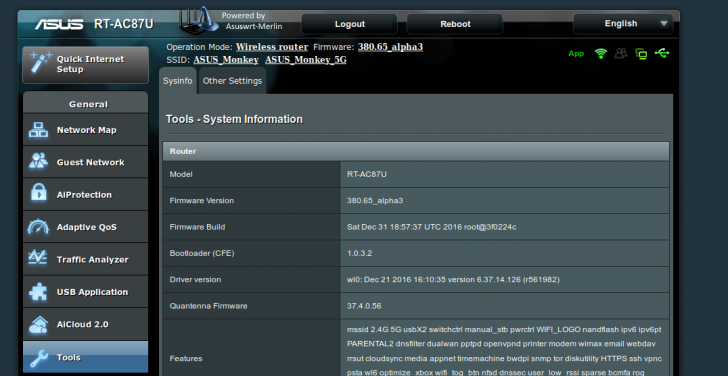

Did I miss something? This is not working in Alpha 3, which is the latest.
^^^ This. Tools-->Other Settings does not appear on either my AC87U or my AC88U with Alpha 3.
This is what I see on both routers:
AC88U.jpg~original
It's in the latest commit, so we'll see it in the next build. In the meantime there's the workaround.
You have to compile your own firmware to have the Tools menu fixed. The fixed menu shown below. 380.65A3 RT-AC87U
Excellent! Thanks for the info!
