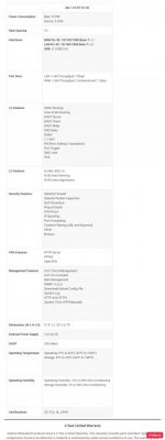

I can't find detailed specs for this router. What OpenVPN speeds it is capable of, for example?
This help?
I haven't installed one with gig service. We only install the AN310 on the networks we do and they are capable of gig speed thru the WAN.

I mean, what's inside, the CPU/RAM. What's the price of this one, without Wi-Fi version?
CPU: 880 MHz
RAM: 512 MiB
Flash: 128 MiB
MSRP is 257.95
