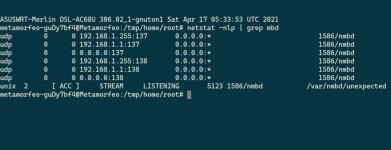

netstat -nlp | grep mbd
This is a output of command.
OK well that explains a lot. The SMB/CIFS server (smbd) is not running, only the name server (nmbd) is. Which explains why you can detect the server but cannot connect to it.

Thanks for that. Can you post the output of these four commands.
netstat -anp | grep -E "139|445"
tail -19 /var/log/log.smbd
tail -19 /var/log/log.nmbd
tail -19 /var/log/samba.log
