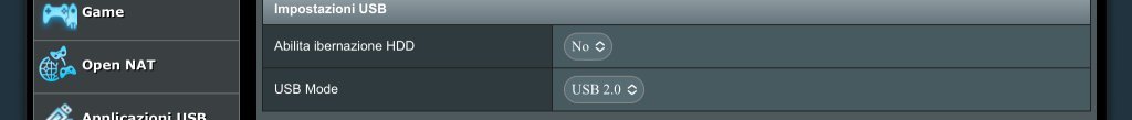

StefanoN
Hi
I hope to found the problem :);): I changed the USB mode to USB2 (before is the default USB3). After this change from 5 hours I don't see the message (before it appeared every 30 sec.). I use the usb for the external disk with ADGuard and enteware.
The only message that appears every 5 minutes is this: kernel: wl0: random key value: .........
What is this message ?

StefanoN
Hi
Some setting were different, now they are the same.
Messages are also gone including the message : kernel: wl0: random key value:
If I put it back to USB3 .... disaster :mad:.
