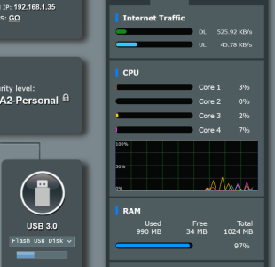

Hello community,
i m a little bit afraid about my Asus Router (with merlin firmware)... I m actually using about the 97% of the RAM.
How could i understand what is using all these RAM? Is it possible that could be done by the DNS DIrector feature?
RT-AX88U Pro
Current Version : 3004.388.6_2

Don't be afraid. Let the router and the RAM do their jobs as they're designed to do.
If and when you have an actual issue, come back and give specifics.
Knowing what uses the RAM won't 'fix' anything. But between Buffers, Cache, and temporary extra usage (as required), the RAM is being utilized correctly and effectively all on its own by the router/OS.

I see you have a USB drive plugged into slot one. And you likely use it to store files that you access from other PC's via Samba file sharing. Having the RAM go up like that is "normal" when you share files. If you are concerned, create a swap file on the USB drive. Then, when the RAM usage gets high the router can use the swap file for more"memory."

The OP has a USB drive attached as indicated by their screen shot in their initial post. Using the File Server (Samba/SMB) option on Asus routers is well known to cause the RAM usage to spike to 97% and stay there for some time when users are copying/accessing files via SMB on the USB drive. There are a number of other discussions on it. I made a post about this RAM usage being stuck at 97% issue when using a USB drive/SMB last year in another discussion:
https://www.snbforums.com/threads/rt-ax92u-usb-smb-seems-fragile-crashes-router.73108/#post-842702
If one is experiencing that specific Samba/SMB issue with the router one can try clearing the router cache to see if the RAM usage drops back to normal usage. Example SSH codes usage to clear the cache (use at your own risk):
sync; echo 1 > /proc/sys/vm/drop_caches
or
sync && echo 3 > /proc/sys/vm/drop_caches
or
free && sync && echo 3 > /proc/sys/vm/drop_caches && free

As explained above this is perfectly normal after reading or writing more than about 480MB of data to the USB drive.
