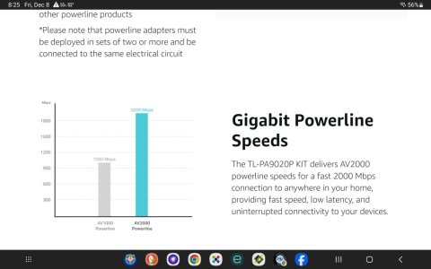

Misleading is not the word I have for marketing.
The text says Gigabit speeds. The graph shows something else.
Gigabit is that '1000' number, divided by 8, which gives us a nominal 125MB/s throughput. Minus any error correction required to ensure accuracy on such poor medium as power cable runs.
Beware of 'Up to'. It rarely is.
And connection speeds are hardly throughput speeds.
And, 1GbE Ports throw a wrench into the numbers above too. I don't believe 2GbE Ports exist. If they used 2.5GbE ports, the cost would not be what I paid for it so many years ago.
