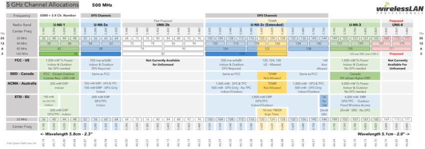

Where is "here"? Different building materials, different RF regulations. Houses in the US are mostly match sticks and drywall; routers are allowed to have up to 1000mW transmit power. Houses in the UK are mostly concrete, brick and stone; routers are allowed to have up to 200mW transmit power. Houses in Israel (where @ChaoscripT lives) are not only reinforced concrete and bricks, but also have bomb shelter rooms with steel plates on doors and eventual windows. Still surprised Wi-Fi coverage is different?

We have up to 200mW here on 36-48 (like in EU), but available and up to 1000mW 149-161 (like in US). We also have matchstick and drywall houses. 🥴
