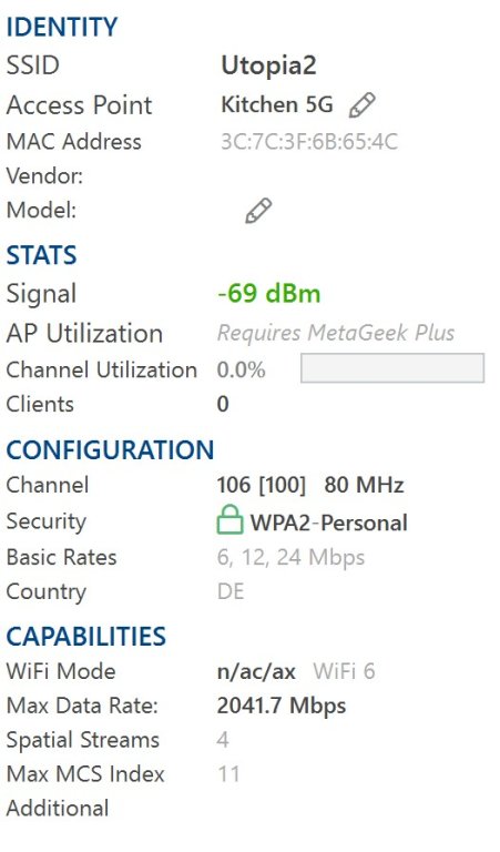

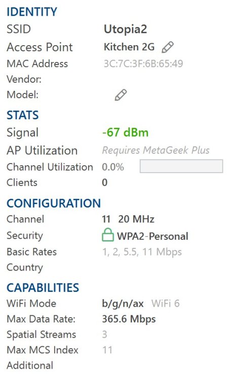

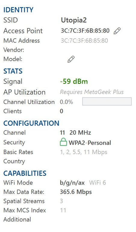

I've just built one AX86U as primary and added the second as a node. Both running Merlin 388.1 after a full reset and then just setting fixed channels and disabling Universal Beamforming. I have the usual report that the node is disconnected when it actually working, however InSSIDer reports that there is a WiFi configuration mismatch between the two identical routers - this should not be the case.
Main Router:
View attachment 46543View attachment 46544
Mesh Node:
View attachment 46545 View attachment 46546
EDIT: Interestingly my IOT devices are happy to connect to the main AX86U, just not the mesh node one. It's the same with the mesh node running stock 388_22068.
EDIT2: More interestingly I added the AX88U as a node running Merlin 388.1 which also seems reluctant to receive IOT clients, but I can bind them and they move happily. The very strange thing is that turning on Ethernet Backhaul immediately redistributed all clients as I would normally expect to give an even coverage. It's as though turning on Ethernet Backhaul pushes some extra config to the nodes.
I'm about to perform the same tests using the latest Asus stock firmware released this week, and if the same will report to Asus
Your IOT devices are probably 2.4 GHz so they get about the same signal from both node and router. Furthermore, when the router comes up the nodes are not up so the IOT devices will go there and many will stick there are they will attempt to connect to the last known good AP
