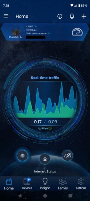

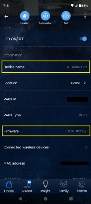

@bennor This router (AX88u-Pro) won't even come up as an option to login in the Asus app anymore. I can only see the older Asus Router AC68P I am using as an AP that also has Merlin on it.
Make sure you are on the main LAN of the router (not on a Guest Network Pro network). App, on an Android device connected to the main LAN of a RT-AX86U Pro running 3006.102.4, see's the RT-AX86U Pro as indicated in the attached images. PS: I don't have AiMesh nodes nor any AP's active at the moment.
