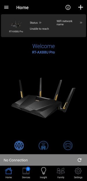

I'm not sure if the issue is with this specific firmware version — whether it's the official Asus version or the Merlin one (only tested the latter) — but after updating from version 3004_388.8_4 to 3006_102.4_0, I'm no longer able to wake my computer remotely using Wake on LAN through the Asus Router app. In fact, the app can't even find my network anymore. If the computer is already turned on, I can still access it remotely using Chrome Remote Desktop, but not with Windows Remote Desktop or Moonlight anymore.
Reverting to the previous firmware version restores everything back to normal.

It's been mentioned several times, a few of those in this very thread:
The ASUS router app is not fully compatible with Merlin firmwares.
*edited to fully convey my intended response and for accuracy
The ASUS router app is incompatible with Merlin firmwares.
It's unfortunate because I've been using Merlin firmware with my Asus app for over a year without any issues, and this is the first time I'm experiencing problems.
The Asus app has been the only reliable way for me to wake up my PC remotely.

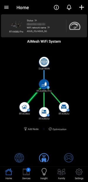

You may have already reset the router, but as evidenced by your prior posts you have also made changes to the router's settings beyond it's default settings. Bottom line, the Asus mobile app is not officially supported under Asus-Merlin. It is up to you on how much time and effort you are willing to expend to try and get it to work under your use case and setup.
I did reset the router and that has fixed the app issue. I can now connect the router to the app as before. I still have issues connecting my RTSP wireless security cameras to their respective app and I am unable to get the Amcrest 5MP doorbell to show up in Blue Iris.
