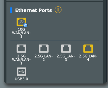

I just noticed something else, using the stock firmware, when I plugged the currently in-use Ethernet cables (certified UGREEN CAT 8 cables), the ports showed in green in WebUI. But in the current Merlin, it shows yellow indicating to replace cables with higher CAT. Also, the suggession given by WebUI is attached which indicates the cable low grade category.
The 10G WAN is connected to my VDSL modem (my internet connection comes from this modem) and the 2.5G is connected to LG C4 SmartTV. Both devices' Ethernet port speed is 100 Mbps.
The devices connected to the router via Ethernet cable are the same when the stock firmware was running on the router.
What's connected to this port? The software doesn't detect the cable, but rather the connection's potential bandwidth.

What is the possible bandwidth of the connected devices?
They both are 100 Mbps devices.

That´s the answer!
EDIT: I think you have to connect at least an 1GB device to turn the ports green in thh web ui.
