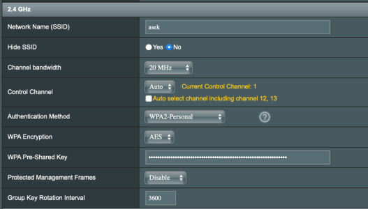

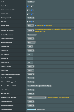

Please provide a screenshot of your Wi-Fi settings. Have you disabled "Protected Management Frames" and all types of beamforming?
These settings are working with my Yamaha RX-A780 at guestnet:

No luck with similar to your settings. Please find attached mine.
Just after changing settings I restarted all AiMesh, and made hard reset of Yamaha. It show after reconfiguration that it connected to wifi, but second later it is disconnected. In Wireless log I see its MAC address, but no IP.
