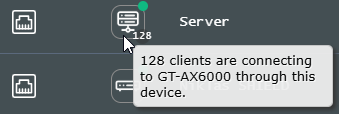

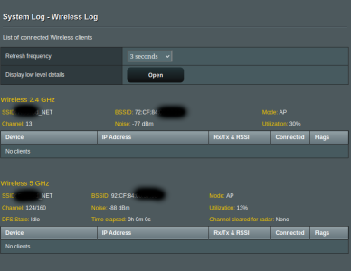

Is this my server (Unraid/Docker/VM) doing something strange or has something changed between .4 stable and this beta affecting this?
Both numbers keep "counting" up every 1-2 sec but drops down to sane numbers after it counts up to 200-250 "clients".
Sane is like Clients: 30-40 and the "x clients are connecting to..." goes away but it starts counting up again and repeats.
Docker is using macvlan so the containers shows up as individual clients/devices and that's fine but I don't understand the ~200 ghost clients that mysterious goes away and comes back.
Edit: Ok. So dirty downgrade to 3006.102.4 stopped this behavior.
This is still happening in beta2.
52 devices connected via my server (0 with .4). And rising.
100+ "clients" in total... and rising (stable at 20-30 with .4).
I don't see these "clients" anywhere. Just the numbers increasing until they drop and start counting up again.
Maybe just visual but it does not feel right.
Edit 164-128=36 is probably near the right number of real clients. Dropped to 0 connected through and now counting up again, and repeats indefinitely. ;)
