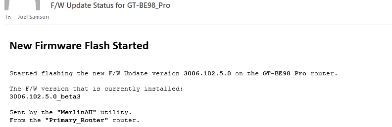

For the first time in a long time I had to do this too. I used MerlinAU FWIW, but to be fair to @ExtremeFiretop I don’t think it makes any difference what you use.
