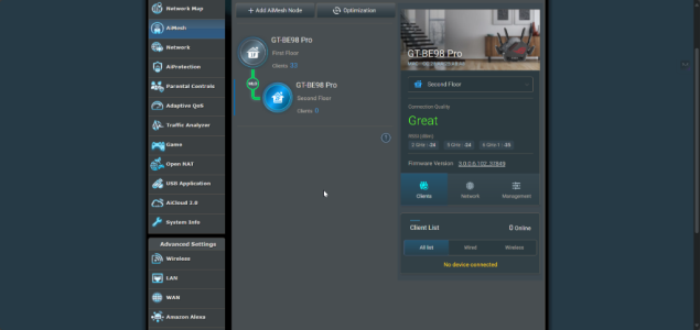

Sorry, it's in my siggy. GT-BE98 Pros.

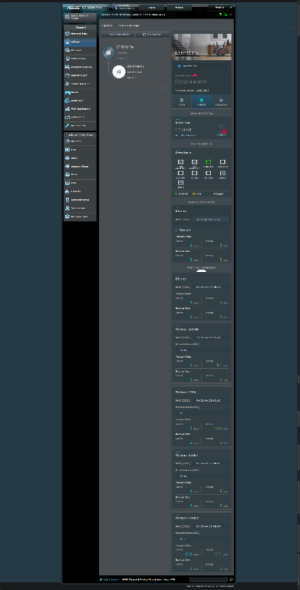

Also, doesn't seem to work wired either... See awesome scrolling screenshot I just took.

Were there any issues reported with aimesh units? main router is perfect, no issues. The mesh unit is basically shutting itself off. reset it a few times. even made itself it's own router and reloaded the firmware. Everytime I add it as a aimesh router it just shuts off and stays offline. I am trying to use it as wireless backhaul. Haven'tr tried wired backhaul yet. About to do that. But I can't "keep it" that way. The old main release was perfect.
I’ve got two mesh nodes up and running perfectly. In my experience, it helps to start the setup using Ethernet backhaul—just plug them in with a cable first. Once everything’s connected and working, you can switch to wireless. It seems to make the whole AiMesh setup process a lot smoother.
