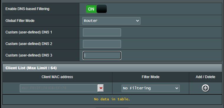

I upgraded my AX88u to AsusWRT-Merlin 386.3_2 and using the DNSFILTER for the first time.
Not sure if I verify the working of DNSFILTER correctly by using the BING9 commands "dig", but the result is not what I am expecting.
The WAN DNS config:
The DNSFILTER config:
Using the "dig" command I expect the same server feedback, the routers IP address 192.168.50.1:

Is my expectation wrong or does the DNSFILTER not work correctly in this case?
The WAN DNS config:
@Tvbaas
Try testing your DNS here: http://www.whatsmydnsserver.com/
