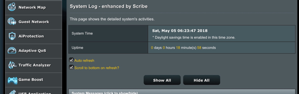

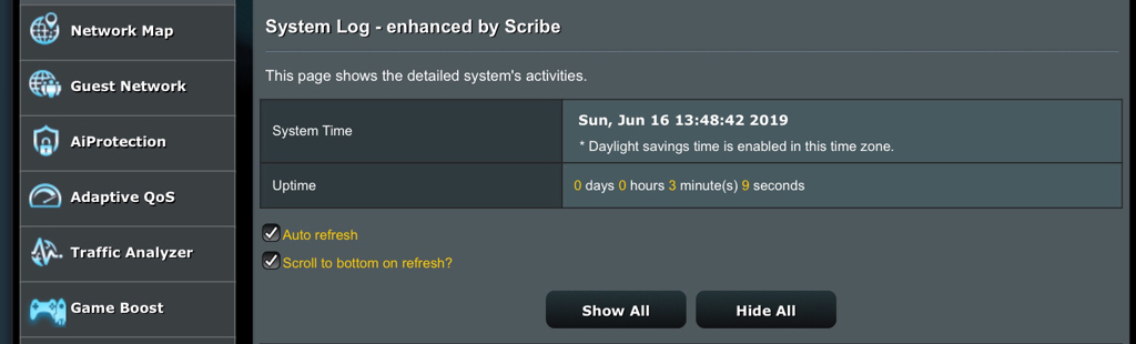

An observation I have which has occurred on previous builds is the clock, date and year fail to update with a message something like NTP server failed, 5 minutes please fix immediately
A second reboot and all is up and running by the time I’ve logged back in.
It’s unpredictable and doesn’t happen all the time
